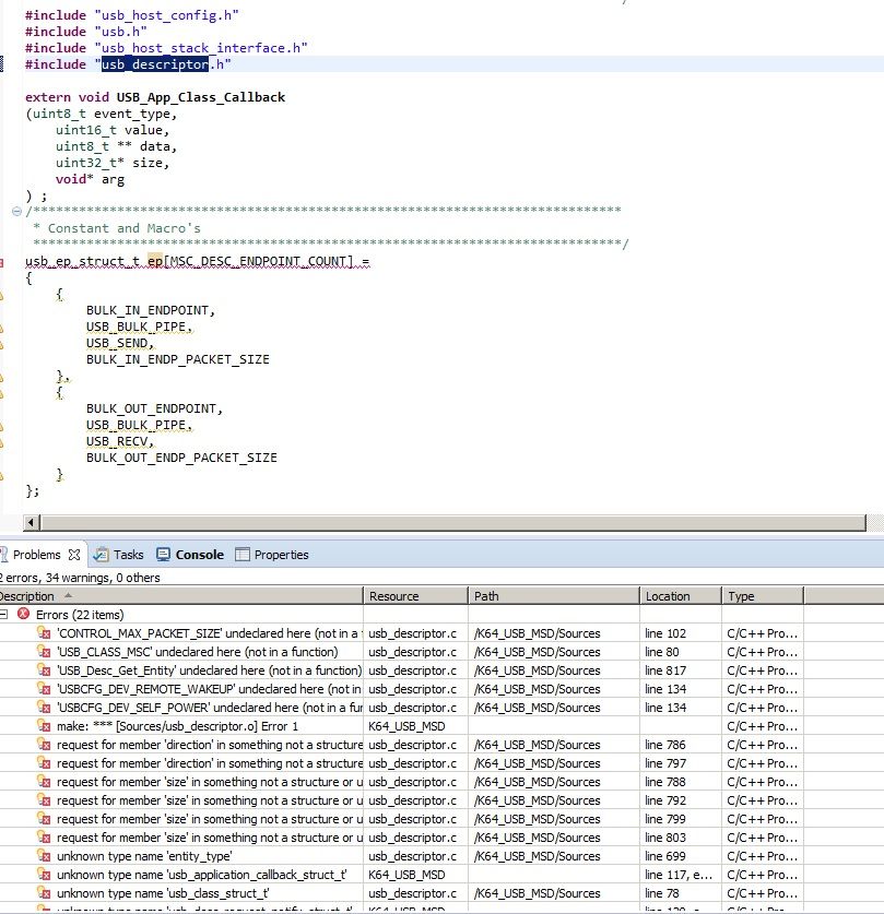

neilporven
Senior Contributor I
Update,
Using the following example: Creating a New USB project with KSDK and Processor Expert support in KDS, I been trying
to build a USB project that is Bare Metal (no PE).  Unfortunately, after fighting multiple issues, I compiled the example and
have the following errors coming from usb_descriptor.c and usb_descriptor.h:
I am not even sure if I need to include usb_descriptor.c and usb_descriptor.h.  The example was used
for a Mouse device (HID) and I am trying to use an USB stick device (MSD - Mass Storage Device).
Can someone tell me if I need to even include the descriptors and if so, why am I getting these errors.
By the way, here is a picture of my include paths:
Neil
