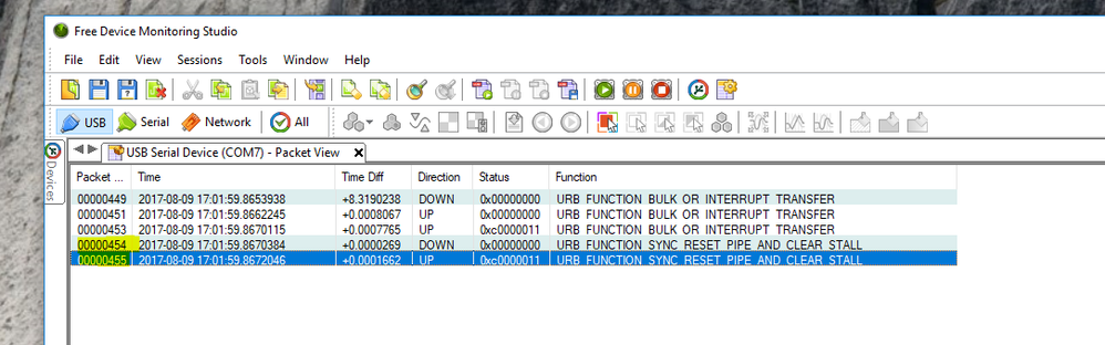

I added a screenshot of what happens when the MCU clock is changed before accessing the flash. The two last entries marked with yellow is the "illegal" behavior (does not happen if I do not change the MCU clock). After this the target no longer responds. I am no expert  on the USB inner working, but hopefully this might be a hint about what is the problem.
