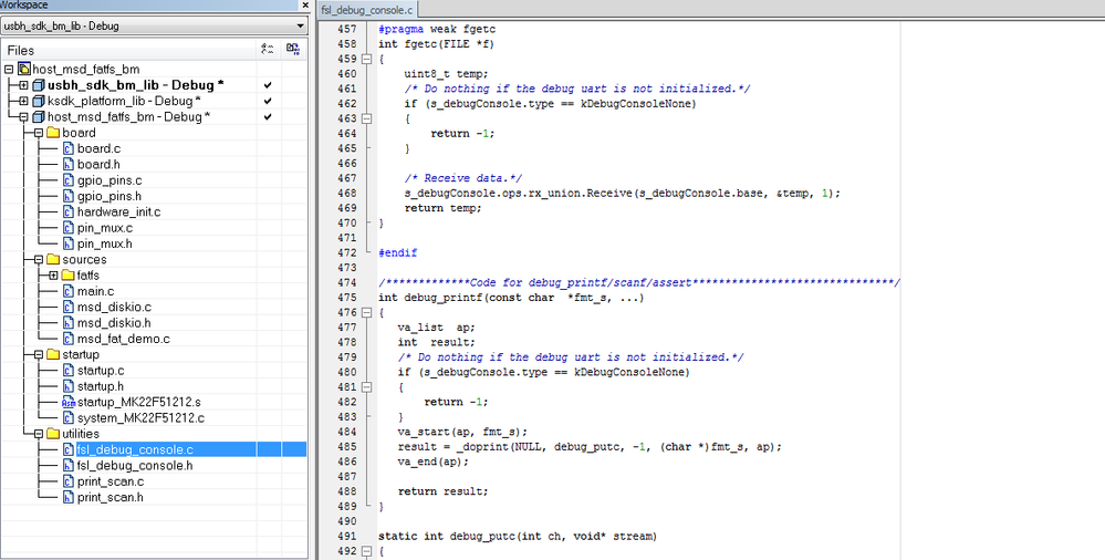

When I include the USB library, libusbh_bm.a, I get the following errors.  They are all pointing to
debug_printf.  I think I am missing a path needed, but I don't know which one. Can someone
tell me if I am missing a path or is it something else?

debug_printf is defined in fsl_debug_console.c, please add the 4 files (under utilities) into your project. , please refer to the host_msd_fstfs_bm demo

I added the utilities folder and the four files as you suggested and now its compiling. I don't have
any code so far, I just wanted to get the SD card and the USB files/folders in the project compiling.
I also enabled both the SD and USB in the preprocessor stage and that seems to be working.
