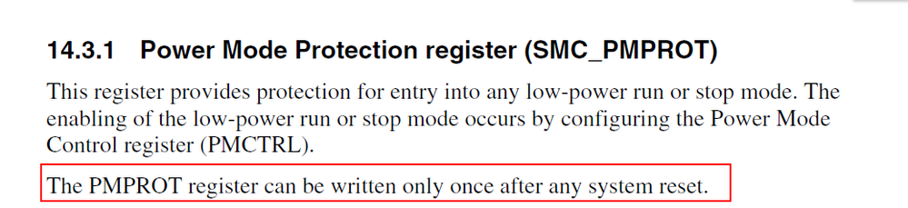

Hello Jared,
Please pay attention that the power mode protection register only
can be written once after any system reset .

3,984 次查看
kyati
Hi Alice,
Thanks for the information about the PMPROT register. It makes sense that the application could not rewrite the protection settings made by the bootloader since there is no system reset, only the jump to application; thus, setting the PMPROT in the bootloader resolved the issue.
