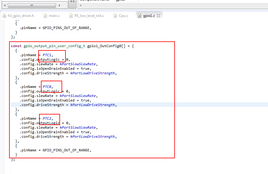

Hello Ken,
In SDK, there isn't the function can set more than one bit . I recommend you directly use the method you mentioned .
And in the initialization , if you want configure some gpio, you can configure here :
then after generate code , you can see the code here :
Hope it helps
