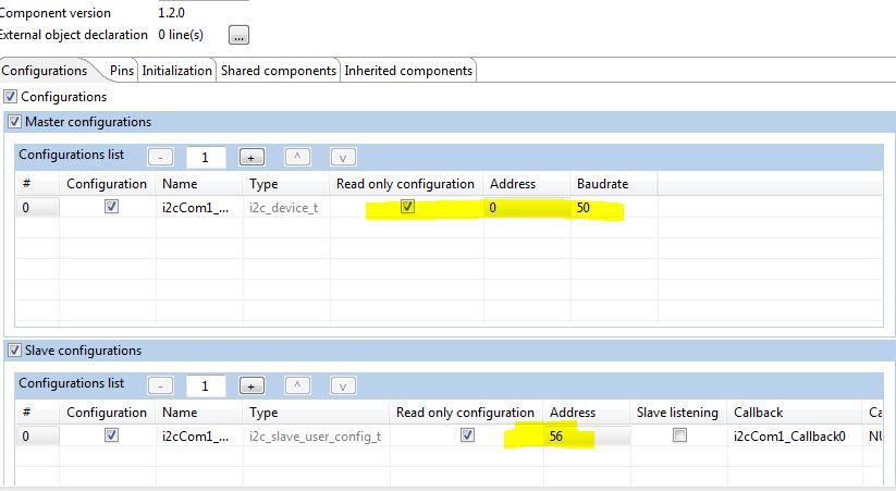

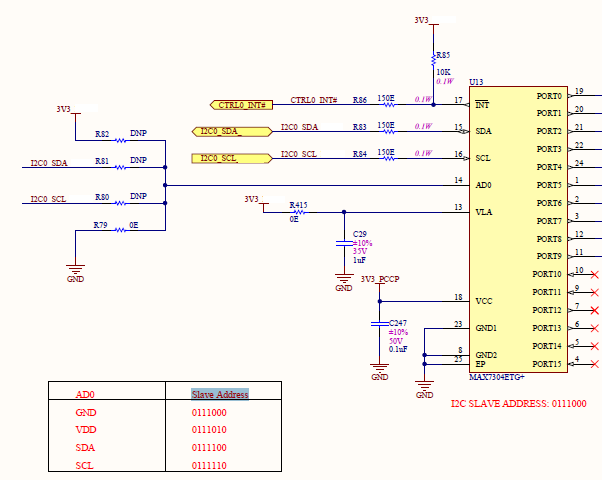

I was actually trying to configure the I2C component through KDS and I have schematics for the hardware as below.
So, I am trying to configure the address of slave in the component so My KDS/PE component config is somewhat as below
While I want to start sending data to I2C, I am still thinking more configuration is required or I am really missing some fundamentals of getting the I2C to work.

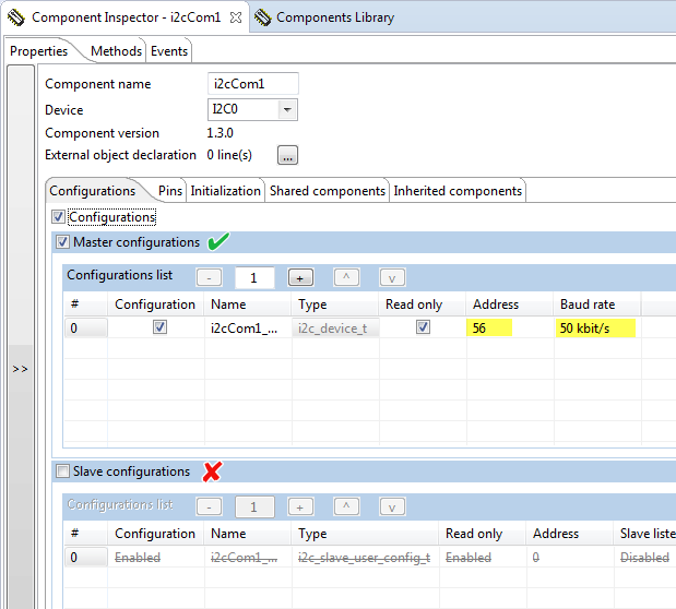

Hello Kewal Deshpande:
In your case the Kinetis MCU will be the I2C master, so there is no need to create or enable any Slave Configurations. Also, the slave address must be specified in the Master Configuration. See the screenshot below:
Now regarding on the use of the I2C driver APIs, you can refer to the KSDK example projects. For example for FRDM-K64F:

Right now,. I was able to dig deeper into the problem. K64 processor connects to a porttexpanderMAX7304 over I2C at 400Khz.
My processor is clocked at 120Mhz, and the bus clock at 60 and the external at 40 Khz.
I am having the clock stretching issue, any idea on how to over come it.. do we need to play with the pullup resistor and capacitance on SCL line.

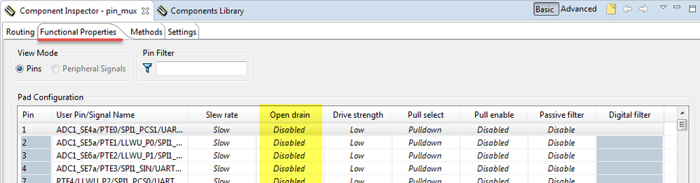

We had to finally configure the SDA and SCL lines for opendrain and the fsl IIC driver worked straight away. I was wondering how could we miss enabling the opendrain through KDS but then we figured out we dont have an option to enable it through KDS.
but as a last question, is there anyway that the pin can be configured to be opendrain through KDS as i am not able to do through pin_mux :: pinsettings as well.

About the Open Drain setting, actually you should have the option in the PinSettings component, under the Functional Properties. Can you see that tab?
