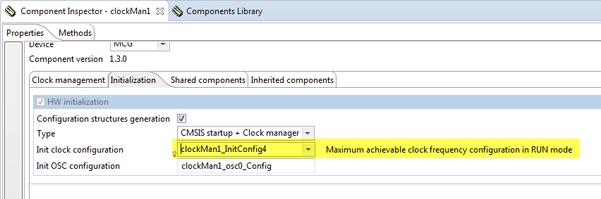

I have run both the flash_example and flash_demo and simply tried replicating this logic within a new project (for a bootloader) using Processor Expert.  I am aware of the demo/example using the bare metal platform library rather than PE but that appears to be the only difference.  My main issue appears to be centered around:
g_FlashLaunchCommand = (pFLASHCOMMANDSEQUENCE)RelocateFunction((uint32_t)__ram_func , LAUNCH_CMD_SIZE ,(uint32_t)FlashCommandSequence);
Whether I'm calling FlashEraseSector, FlashReadResource, FlashProgram, etc.  They all call:
ret = pFlashCommandSequence(pSSDConfig);
This always returns 0x20 (FTFx_ERR_ACCERR)
Attached is my test project, at this point I really can not tell a difference between the demo and my test application in regards to utilizing this driver.

Hello Steven Neves:
Flash erase/program operations are not possible in HSRUN mode (maximum frequency). Try setting Clock Configuration 4 in your project:
Then generate code, build and try again. I hope this helps.

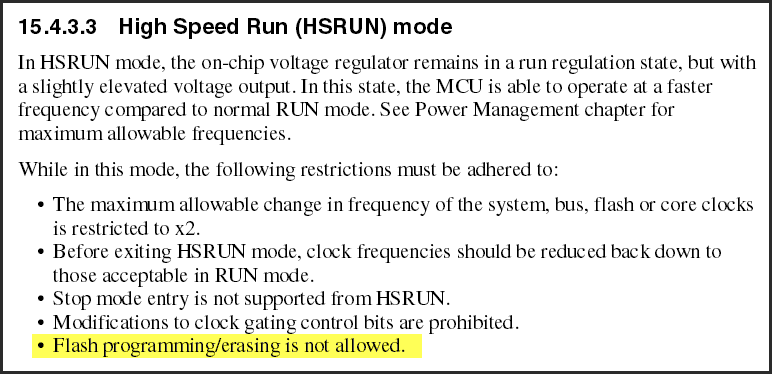

Thank worked.  Thank you very much.  Is this documented anywhere by chance?
2,170 次查看
Jorge_Gonzalez
Hello Steven:
I am glad it worked. This limitation is documented in the Reference Manual:
