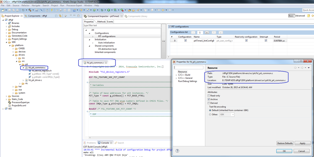

ivadorazinova
Hi Prof Programmer,
please is it possible to send us your screenshot of Properties for fsl_pit_common.c ? Or upload your project here for us?

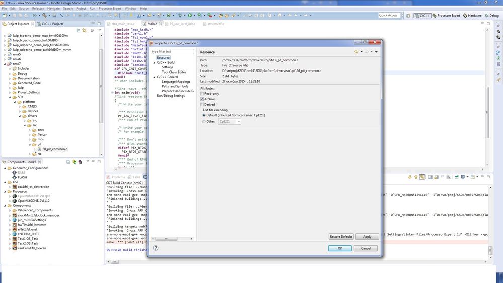

profprogrammer
Here my screenshot of fsl_pit_common.c properties.
My project.
https://community.freescale.com/servlet/JiveServlet/download/579756-364812/nmk7.zip

TICS_Fiona
Please click on 'Project' menu-> Clean to remove the object file and rebuild again. Does it work?
If not, please double click on the file ‘fsl_pit_common.c’, can this file be opened in KDS editor window?  And right click on the file to select ‘Properties’, is its path and location displayed in the pop-up window correct?

profprogrammer
I tried these actions didn't help to isprativit a mistake.
