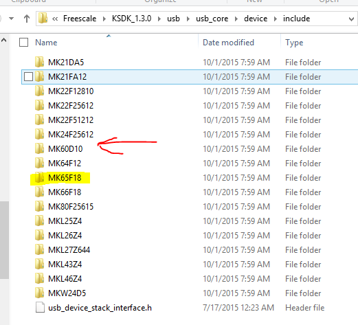

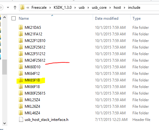

I'm using the MK26F on a custom board. MK26F is supported by KSDK1.3.
However MK26F seems to be missing from the KSDK1.3 directory tree.
Is it OK to substitute the K65F18 instead?

Hi Neil,
You can use the TWR-K65 example code for K26.  K26 is subset of K65.
Then you can use the following example:
C:\Freescale\KSDK_1.3.0\examples\twrk65f180m\demo_apps\usb\host\cdc\cdc_serial
David

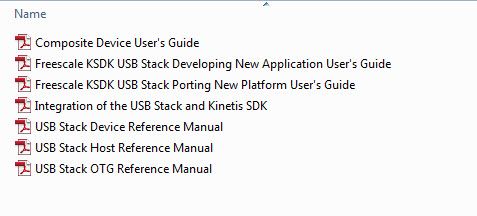

jeremyzhou
Hi Neil,
I'd highly recommend that you can find some useful documents about KSDK USB stack which reside in ~\Freescale\KSDK_1.3.0\doc\usb, such as reference manual and porting new platform user's guide.
And I think these documents will do a great favor for you.
Ping
2,454 Views
neilhancock
Thanks for the references. Yes I had found them and very much appreciate some of the explanation in them.
