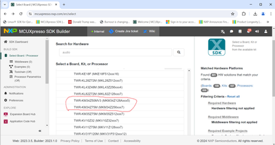

There is flashloader for KM34, pls refer to the Fig, I copied from SDK menu.
Hope it can help you

Thanks for the clarification, But i found that SDK version 2.15 of KM35Z75M has the updated bootloader which works perfectly fine for KM34Z75M Board.
