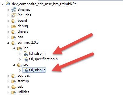

Basically, you'll need to add these files for your project:
Then, you will have to create functions needed for this middleware to communicate through SPI:

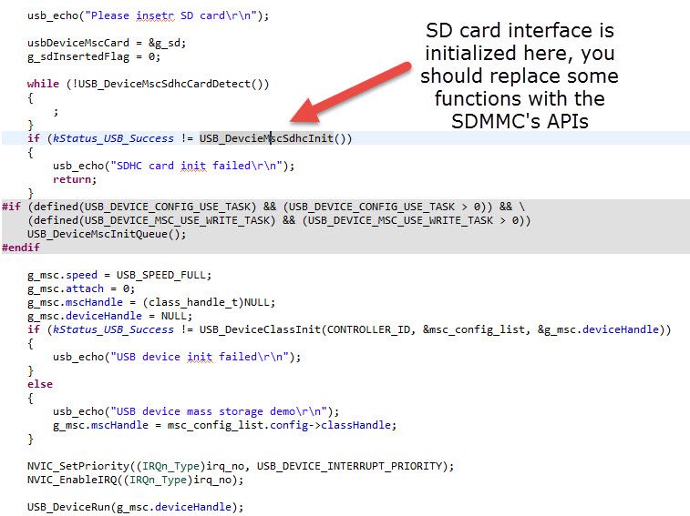

Next step is to call these APIs every time that a read/write procedure for USB MSD interface is needed. For this, you can use the USB MSD SD card example available for FRDM-K64F to check the exact procedure that application takes to initialize/communicate over USB. This example is available at: <SDK_2.0_FRDM-K64F_PATH>\boards\frdmk64f\usb_examples\usb_device_msc_sdcard\bm.
For example, there is a section where SD is initialized, and you will need to replace some functions inside this USB_DeviceMscSdhcInit to perform communication with SD through SPI interface. Some of these functions are already defined in the fsl_sdspi.h driver that were included before.

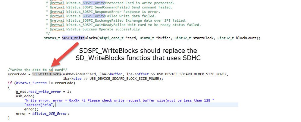

And in MSD's callback, you must replace APIs that write/read to/from SD, to those functions that are already defined in fsl_sdspi.h:
This should be the best way to implement SD card support on USB MSD + CDC example. (I'd strongly recommend to implement this on USB MSD device example before adapting to MSD + CDC example)
