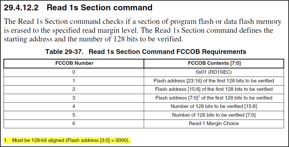

The FlashVerifySection command makes use of the "Read 1s Section" command from the Kinetis Flash module. For K64 you can see in the Reference Manual that the required alignment is 16 bytes (128 bits):
With 16 x 256 = 4096 bytes you can see that the whole 4 KiB sector is verified.

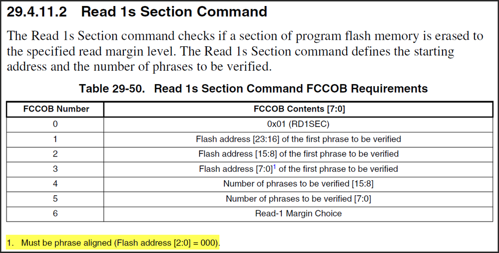

For the K22FN512 the alignment would be 8 bytes (1 phrase):
Then Number is calculated as next:
Number = FTFx_PSECTOR_SIZE / FSL_FEATURE_FLASH_PFLASH_SECTION_CMD_ADDRESS_ALIGMENT;
Number = 2048 / 8;
Number = 256;
I hope this clarifies.
