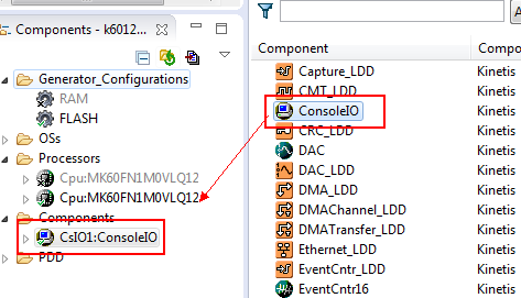

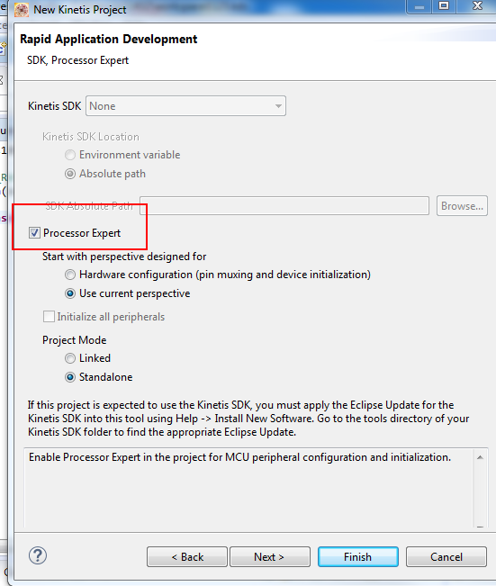

Hello Ken,
Yes, the KSDK1.3 is the latest version now , and it have not support the board of TWR-K60120M.
I think you can also use the Processor Expert driver to development your project , and there are the component of
peripherals , it only need add them you need .
If you want use , when you create project , please select it :
For example , if you want use the print words through UART , you only need add the component of "ConsoleIO":
Hope it helps
Alice
