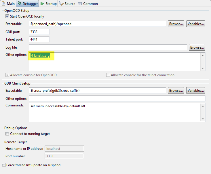

When I do debug-->debug configurations-->GDB OpenOCD Debugging-->hello_world_frdmk22f debug, I get an error:
     "Missing mandatory configuration. Fill-in the 'Config options:' field in the Debugger tab"
I haven't a clue what I should fill in there though.

I confirmed that KSDK is installed in KDS
adding  -f kinetis.cfg did not change the behavior.
The build console is still reporting:
**** Build of configuration debug for project hello_world_frdmk22f ****
Nothing to build for project hello_world_frdmk22f

Please, have you installed KSDK into KDS?
I mean this part -> http://cache.nxp.com/files/microcontrollers/doc/user_guide/KDSUG.pdf#d74e5a1310_d11e411
Please, do you have added -f kinetis.cfg in other options?
For more details please see KDS Debug Configurations (OpenOCD, P&E, Segger)
Please let me know, if this helps you.
