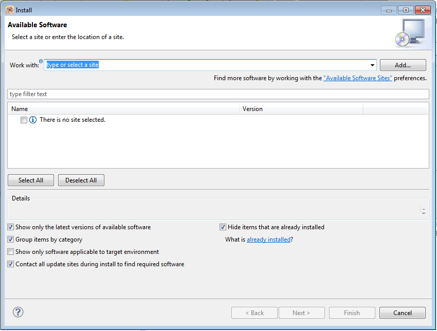

Hello dear Freescale community
I am new to Freescale and I just got a FRDM-KL03Z board, I followed the quick-start guide, but it was quite useless.    I downloaded the KDS v. 3.0, but I don't see the board listed.  Any help?  I was reading about an SDK patch for this board, but I can not find a download link for it.
Any help would be great,
-Carlos

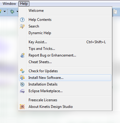

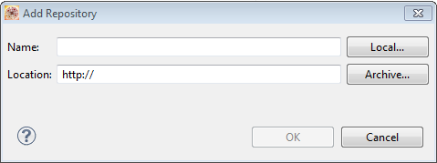

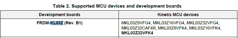

Hello Carlos Tadeo Ortega Otero,
you also need KSDK installation. Please, install it from our websites from Software Development Kit for Kinetis MCUs|Freescale
all supported MCU for KSDK you can find in your KSDK folder at Release Note, which is located at C:\Freescale\KSDK_1.2.0\doc
For SDK patch in KDS you need to install Eclipse Update, Help -> Install New Updates
and add the Repository, which is located at C:\Freescale\KSDK_1.2.0\tools\eclipse_update\KSDK_1.2.0_Eclipse_Update.zip.
I hope it helps,
Iva

Thank you! Worked perfectly. I am starting to enjoy KDS.
