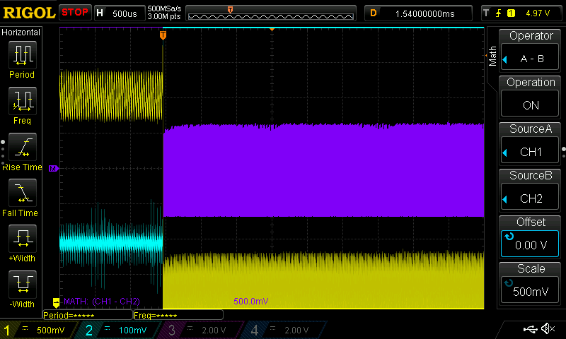

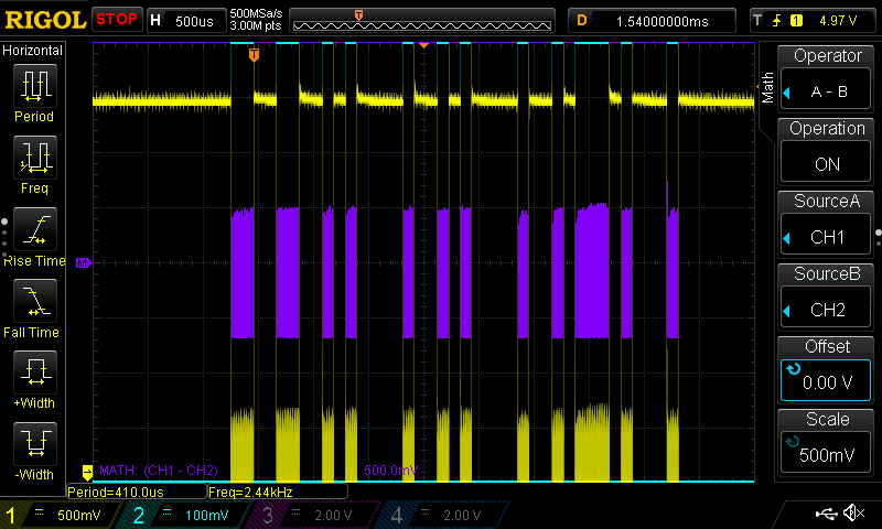

I am using the FRDM-K64F for evaluation of the K64 for possible use in a commercial project. I am fairly new to KDS and the SDK 2.0 so please bare with me! I am able to get UART3 working via pins PTC16/PTC17 no problem with a simple mbed program, however when I try to do the same within Kinetis Design Studio using SDK 2.0 I can't get UART3 to work. I have UART3 connect to an RS485 transceiver, and when monitoring on a scope here is what I see when using mbed firmware:
And I receive the message as expected. However, here is what I see when I attempt to use UART3 with firmware created with KDS and SDK 2.0:
I am assuming I must just not be muxing or initializing something correctly but haven't been able to figure it out. In my firmware, I am beginning with the Hello World demo app from the SDK2.0, and only adding minimal code to attempt to get basic functionality from UART3.

Hi, Michael,
I think your code is okay, especially, the pin assignment part.
Regarding your issue that the noise is large, I suppose that you connect two board together, especially, the two boards ground together via float wire, which leads to the noise.
If you dismantle all the float wires, test only the FRDM-K64F board,  test the uart3 TX pin with scope, does the issue exist?

thunderfoot
Hi Xiangjun,
I seem to have gotten UART3 working now by following the tips from this thread: https://community.nxp.com/thread/387282
To be honest I'm not exactly sure why this is working and my previous tests were not. The code and pin muxing is very similar, I just started with a different SDK example (selecting the one mentioned in that thread) and swapped UART3 in place of UART0. If I discover the specific problem from before I will share it here, but otherwise at least now I can push forward with some working code!
