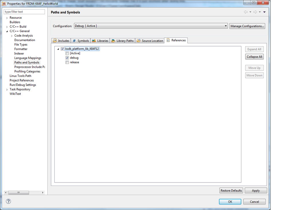

4,100 Views
stephenspears
I thought this was fixed by checking the Reference box (see above) but that has created a new error.  When I checked that box it added a library and library path.  There doesn't seem to be a library there as it throws the error below.
'Invoking: Cross ARM C++ Linker'
arm-none-eabi-g++ -mcpu=cortex-m4 -mthumb -mfloat-abi=hard -mfpu=fpv4-sp-d16 -O0 -fmessage-length=0 -fsigned-char -ffunction-sections -fdata-sections  -g3 -T "MK64FN1M0xxx12_flash.ld" -Xlinker --gc-sections -L"C:\Freescale\KSDK_1.2.0\lib\ksdk_platform_lib\kds\K64F12" -L"C:\Freescale\KSDK_1.2.0\lib\ksdk_platform_lib\kds\K64F12\debug" -L"C:/Users/SSpears/workspace2.kds/FRDM-K64F_HelloWorld/Project_Settings/Linker_Files" -Wl,-Map,"FRDM-K64F_HelloWorld.map" -specs=nosys.specs -specs=nano.specs -o "FRDM-K64F_HelloWorld.elf"  ./Sources/Utilities/fsl_debug_console.o  ./Sources/Board/board.o ./Sources/Board/gpio_pins.o ./Sources/Board/pin_mux.o  ./Sources/main.o  ./Project_Settings/Startup_Code/startup.o ./Project_Settings/Startup_Code/startup_MK64F12.o ./Project_Settings/Startup_Code/system_MK64F12.o   -llibtemplatestatic -l"ksdk_platform"
c:/freescale/kds_3.0.0/toolchain/bin/../lib/gcc/arm-none-eabi/4.8.4/../../../../arm-none-eabi/bin/ld.exe: cannot find -llibtemplatestatic

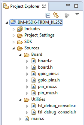

4,100 Views
EarlOrlando
Senior Contributor II
Hello Stephen,
Do the Board and Utilities folders contain all the files as is shown below?
Earl.
4,100 Views
stephenspears
Hi Earl,
Yes, I have all of the correct files.  I managed to figure out the problem.  All of the check boxes under References below were empty.  I selected debug as shown below and those errors cleared.
