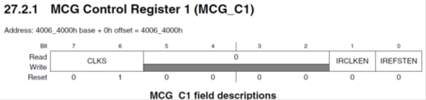

shauldorf
Contributor V
Hello Rong
The problem with FlexIO clock = MCGIRCLK was solved there is MCG_C1 register with IRCLKEN field which enables IRC8M module.
Thanks for your helpful and fast response support.

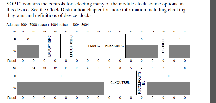

Hi, Shaul,
I am sorry. I think you have to select the FlexIO clock source with FLEXIOSRC bits in SIM_SOPT2, the default is 2b'00, which disable any clock.
Xiangjun Rong
FlexIO Module Clock Source Select
Selects the clock source for the FlexIO transmit and receive clock.
00 Clock disabled
01 IRC48M clock
10 OSCERCLK clock
11 MCGIRCLK clock
3,982件の閲覧回数
