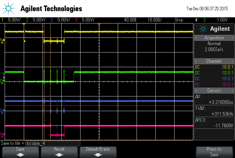

I am working on a custom board equipped with K66 MCU(120MHz, and 60MHz bus clock), serial Flash, and other peripherals. The purpose of serial Flash is just for data storage. I have successfully read the device JEDEC ID through DSPI bus 1 (20MHz baud). However, based on the scope observation, the delay between 8-bit frames are too long (approximately  3.2us). Please refer to the following scope screenshot,
Yellow signal: PCS0 on DSPI1,
Green signal: CLK,
Blue signal: SOUT, and
Pink signal: SIN.

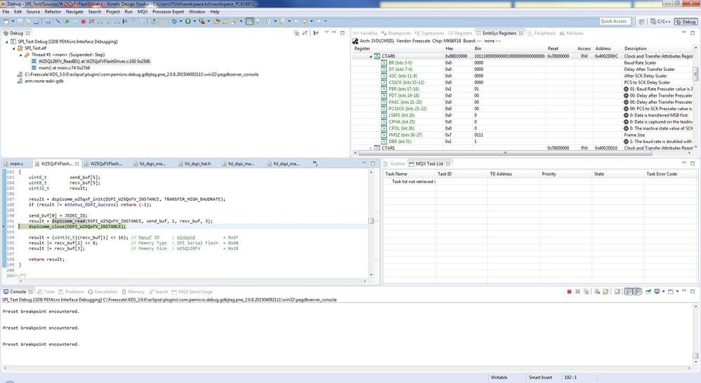

I would like to have minimum delay between transfer by setting delay with DSPI_HAL_SetDelay() function. Based on the calculation,
PCSSCK=0, CSSCk=0 --> tcsc=(1/60M)*1*2=33.3ns
PASS=0, ASC=0, tasc=(1/60M)*1*2=33.3ns
PDT=0, DT=0, tdt=(1/60M)*1*2=33.3ns
I have verified the register has been correct set to zero before calling transfer. Based on the reference manual, the delay between transfer should be tasc+tcsc or maybe even none. However, I have 3.2us between transfer. This is too much away from specification. I wonder if any thing wrong in my code. Please let me know if you have idea or recommendation. Thank you very much.

Of course, you are right that the PDT/DT bits in SPIx_CTARn determine the interval between two SPI transfer. If you do not call the SDK function and write the SPIx_PUSHR register directly, I think the interval between two transfer will be very short which is based on the DT/PTD mechanism. I have checked your code, I think the code is okay, but the SDK is a high level function, the DSPI_DRV_MasterTransfer() function just put the data to an internal buffer, the code efficiency is low, which leads to the interval is long. If you require the speed of SPI, I suggest you write register directly without calling SDK function.

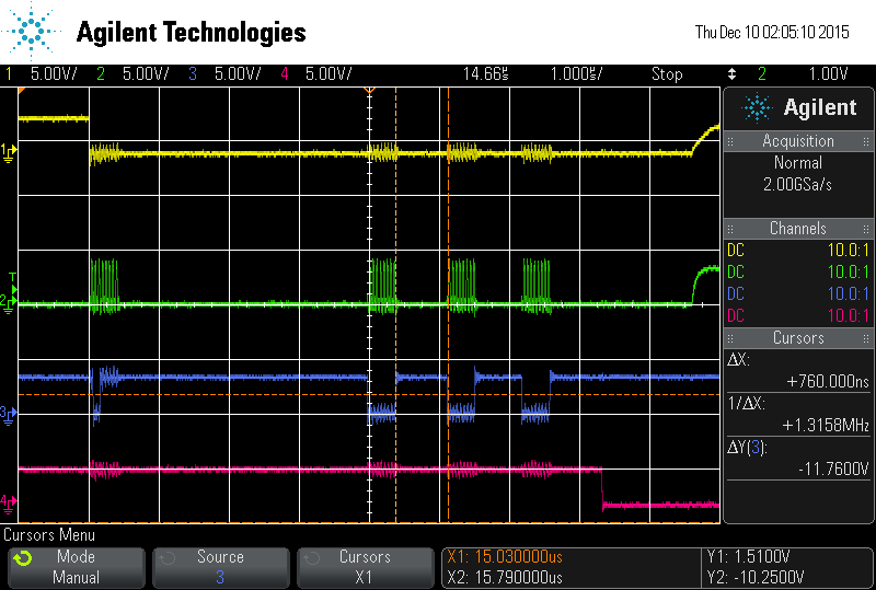

Based on your feedback, I have tried to send data by writing to PUSHR register without calling KSDK, it gives me the best situation 760ns between transfer, which is much better than before. I think it will be OK for my system.

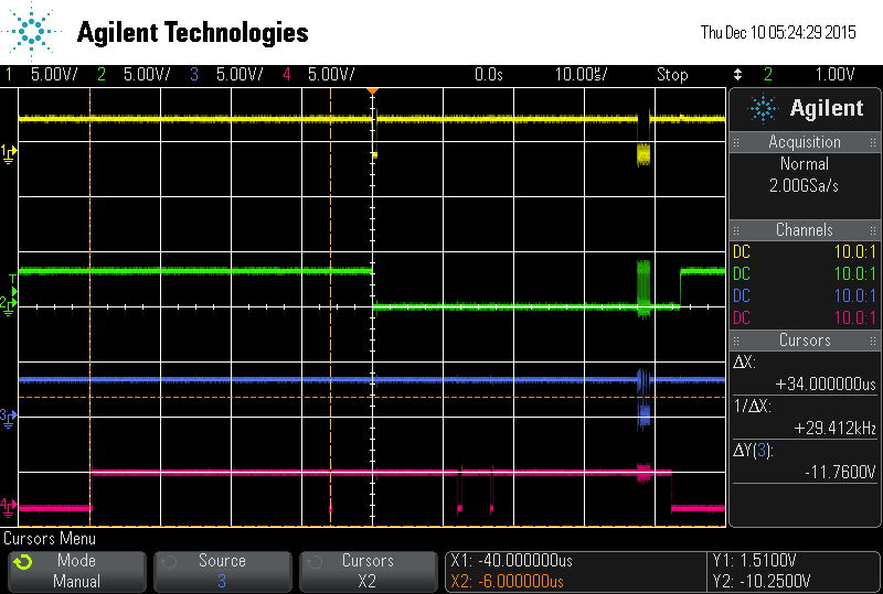

I also tried to implement based on eDMA in KSDK, it gives me pretty good 67ns between transfer. However, the initialization takes 45us to complete. I will assume it will be good for large quantity of data transfer, not for 4 bytes data transfer.
