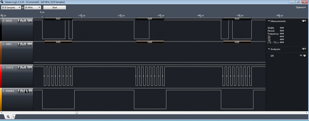

I'm trying to perform a multi-byte SPI transfer using the KSDK 1.2.0 "fsl_spi" component, as follows:
  uint8_t sleepStringOut[] = {0x02 /* WRITE */, 0x0F /* ADDR = CANCTRL */, 0x20 /* REQOP = 0b001 */};   uint8_t sleepStringIn[] = {0x00, 0x00, 0x00};   spi_status_t result;    result = SPI_DRV_MasterTransferBlocking(SPI0_IDX, NULL, sleepStringOut, NULL, 3, 10000);   if(kStatus_SPI_Success != result)   {    for(;;) { /* Trap */ }   }
Looking at the SPI bus on a logic analyzer, the driver de-asserts the slave select line between each byte of the transfer:
Is it possible to configure this driver to perform a multi-byte SPI transfer without de-asserting slave select between bytes?
Dave
3,802 Views
davidrea
Since this is just a small test build, I ended up just reconfiguring the slave select line as GPIO and asserting it in software...

codylundie
Have you dove any further work on this particular issue? I've just begun development with the 1.3 version of the SDK and this behavior is still occurring and my SPI device does not respond. After much frustration and troubleshooting I narrowed it down to the CS line de-asserting itself in between bytes of the same transfer. Wondering if you determined if there's a bug in the SDK and whether you had a solution?

yijunma
In my K21 SPI component:
dspi_status_t DSPI_DRV_MasterInit(uint32_t instance,
                                  dspi_master_state_t * dspiState,
                                  const dspi_master_user_config_t * userConfig)
There is a member <isChipSelectContinuous> in the 3rd parameter userConfig.
3,802 Views
davidrea
Yijun,
Thank you for your reply. I am working with a KL25 part that has a standard SPI component, not a DSPI. The definition for spi_master_user_config_t looks like:

yijunma
Dave ,
Another clue:
SPI_HAL_SetSlaveSelectOutputMode(base, kSpiSlaveSelect_AutomaticOutput);
or you can check KL25 Reference Manual for SPI settings.
Maybe KL25 and MK21 has different SPI architecture.
