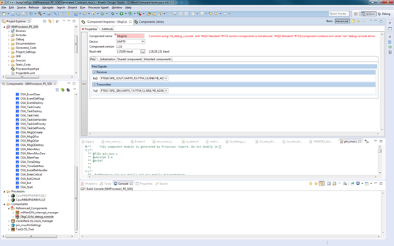

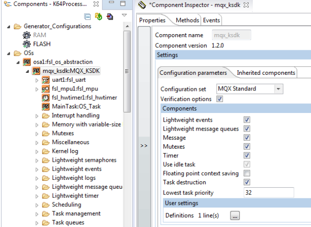

Hi All,
i create a new a Kinetis project using Kinetis SDK1.2 and Processor Expert,  and then i add OS componet, and set OS as MQX Standard.

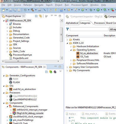

After i set as MQX Standard,  PE will add DbgCs1:fsl_debug_console components automatically into Referenced components file foler, shows below.
Then, i got the isue, it's not allowed.  it was added automatically, but then it says not allowed, how can i fix it?

just remove the debug_console component, for mqx has it's own debug out put

Thanks kevin, remove the debug_console componet can fix the problem, but just want to make sure it's okay to remove it.
2,961 Views
ivadorazinova
Hello Kevin,
yes-exactly. It could be the problem.
