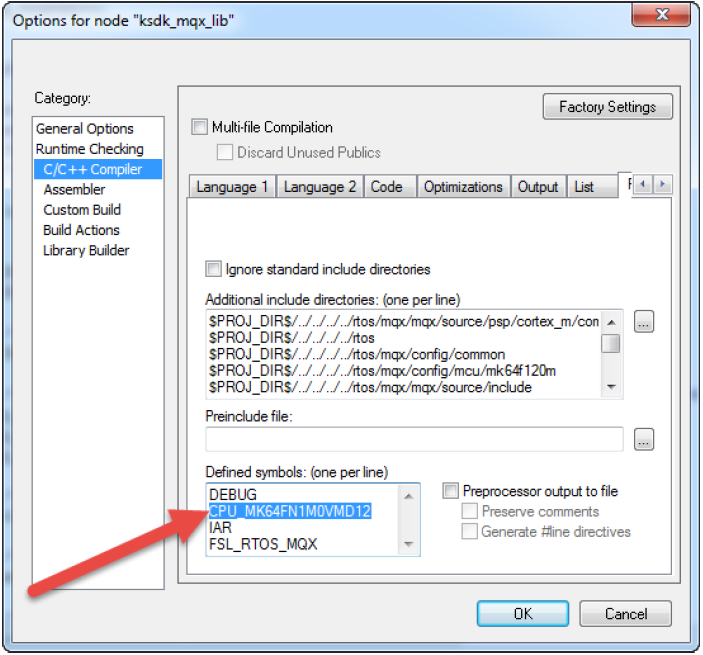

The derivative in your case should be CPU_MKL03Z32CAF, with no ‘R’ on the end.  In the part number, the ‘R’ just means it comes on a reel.  Also, in KSDK v1.3.0, you can find all the supported CPU derivatives in the file \KSDK_1.3.0\platform\devices\fsl_device_registers.h.  So if in doubt, you can search in that file for your MCU and find the macros available there for your derivative.
And I apologize about the second image.  That screenshot is for the IAR toolchain, and it does not apply to the KDS toolchain.  I need to update the training presentation to fix that error.

In KSDK, the MCU derivative is changed using a preprocessor macro definition in the project settings.  Below is a link to a KSDK hands-on training.  Slides 93-99 cover how to change the derivative.
https://community.freescale.com/docs/DOC-328379

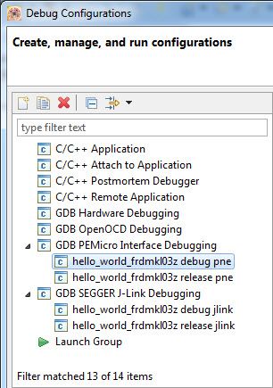

In KDS, to change over to a different hardware debugger, you can select or add a different Debug Configuration.  Use the KDS menu Run->Debug Configuration.  For example, to use a P&E Multilink debugger, select a Debug Configuration under “GDB PEMicro Interface Debugging”, see screenshot below.  Also, the KDS User Guide installed at C:\Freescale\KDS_v3.2.0\doc\KDS_Users_Guide.pdf has more details on Debug Configurations, in section “Debugging Projects”.

I read through the slides you linked to, I changed the processor derivative in the dialog box shown below and got 'no valid processor selected errors when I tried to compile.  I changed it back to the original ...VFK4 and it did cure the errors.
But I can't find the dialog box you showed on slide 97 "Option for Node..." (YOUR slide shown below)
