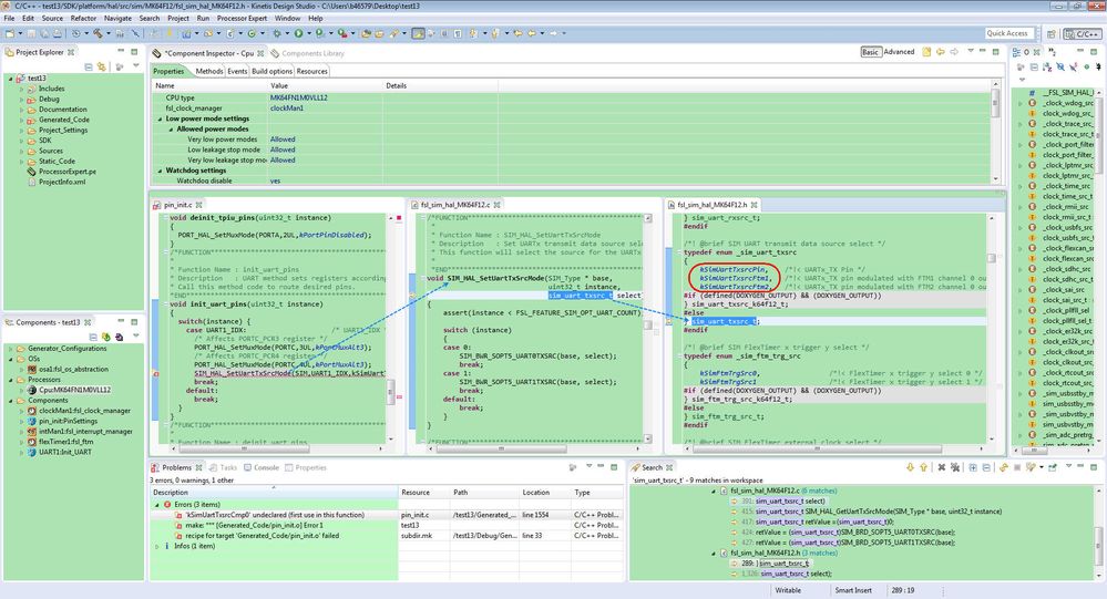

Using processor expert i get an error in the pin_init.c file on function call "SIM_HAL_SetUartTxSrcMode(SIM,UART0_IDX,kSimUartTxsrcCmp0);" the error is
DescriptionResourcePathLocationType
'kSimUartTxsrcCmp0' undeclared (first use in this function)pin_init.c/BM-PEx-KSDK-FRDM_K64F-FTM/Generated_Codeline 1554C/C++ Problem
tried SDK 1.2 also same results. I attached the basic project of just the UART and FTM configured and the pin mux set to modulate uart1 TX.  Anybody able to pull this off with PE and KDS?

Hi michael,
Please select kSimUartTxsrcFtm1.
