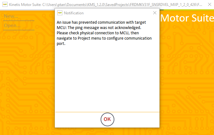

I've tried disconnecting the board, reconnecting it, closing KMS, reopening it, but I cannot seem to get a connection.

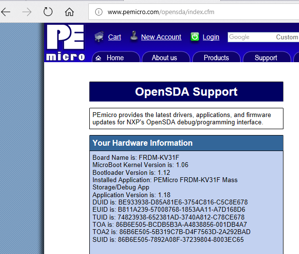

The board information seems ok.
Can someone help me and let me know what I'm doing wrong??
Thanks.
Paul Tan.

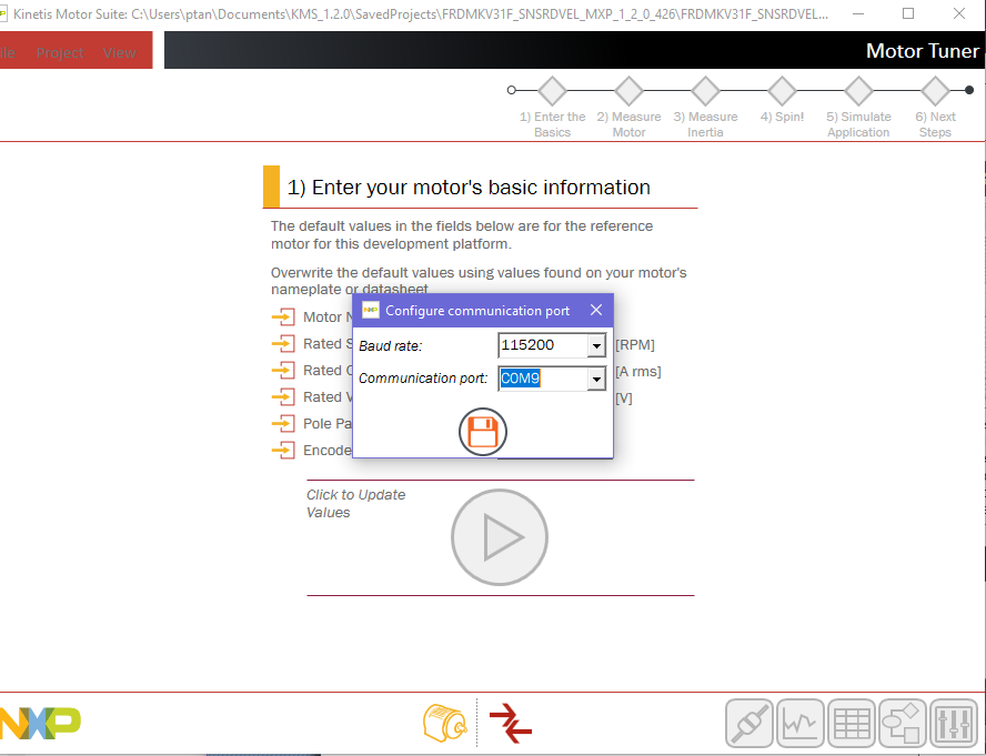

Hello Paul,
   There is few information so I will assume you have a KMS capable MCU and KMS image was not erase. And right COM port was selected.
   In this case, I suppose you have and old image, not supported in KMS1.2 and you need to update it. After communication fail screen, go to Project menu and Select Load Application Image.
   Reset board and try to connect again.

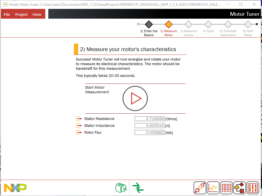

Thanks!  That fixed the problem!!!

PaulTan
Hi Renato,
Thanks for the quick reply.  What application image do I load?
EDIT: Never mind, I just realized it was looking for the nxpresso path.  I'm loading the application image now, and will update you.  Thanks!
