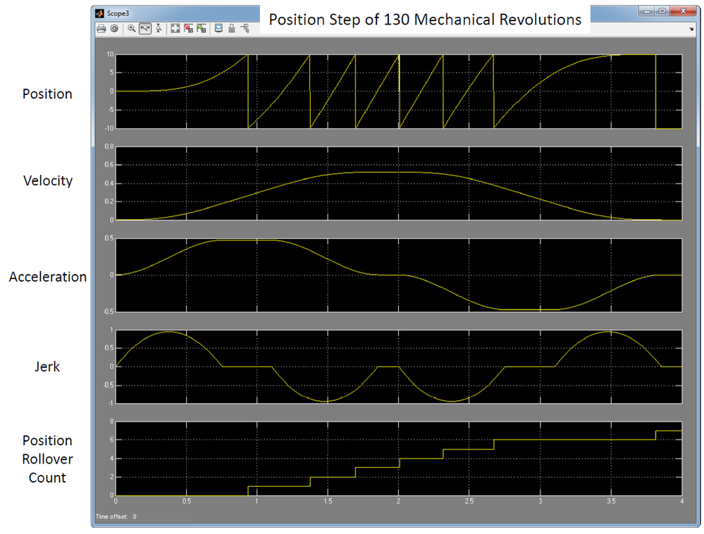

For example in the above image, I told the profile generator to rotate 130 mechanical revolutions.  As you can see each time the mechanical revolution became larger than 10, it rolled over to -10 immediately and the position rollover counter increased.
I think the simplest path for you to avoid the large number of start/stop cycles would be for you to create your own profile generator that will generate a position reference signal according to the above image & description that will increase (or decrease) the position reference based receiving external clock interrupts.
You should be able to avoid creating the velocity, acceleration, & jerk references since they are only used for feedforward.  Obviously, if you did create them the performance of your system would be better.
