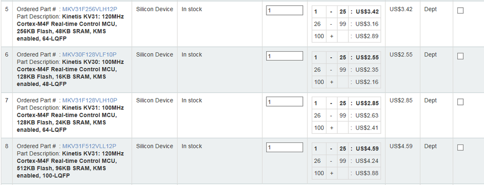

The KV series of MCUs including the three you mentioned, the KV1x, the KV3x, and the KV4x MCUs call all drive a BLDC or PMSM motor.  The BLDC motor, as Adam mentioned can be driven with a standard 6-step commutation algorythm or a sensorless (back EMF) method or with sensorless FOC.  There are two basic motor control options from NXP, 1) the Kinetis Motor Suite - which uses a sensorless FOC algorythm or 2) a Kinetis Motor control reference design. For people without a lot of motor control expertise the KMS offers a tuning ability to get the motor running.
The KV3x MCU family includes four devices ranging in size and speed from a 512K flash 120Mhz part down to a 64K flash 100 MHz part. Any of them can be used with KMS. The MKV31F512xxx12 is what is used on the MCU evaluation boards as a superset part of the MCU family.  In you end application you can utilize any one of the four MCU parts.
The
MKV30F128VLF10P                        ,
MKV31F128VLH10P                        ,
MKV31F256VLH12P          , or the
MKV31F512VLL12P
Your choice of the most expensive of these, the 512K part would only be driven if your application code, added to the motor control reference project (KMS takes approximately ~64K), takes up the rest of the flash.
If your code was very small and it and the KMS software fit into the less expensive 128K flash MCU.
There are instructions in the KMS documentation as to how to change the reference project to the other devices.

I see the KMS generate 64k bytes.
Why did you recommend  MKV30F128VLF10P instead of some KV10?
My code will be too small and I maybe I can use 64k in my end application.
KV10 are cheaper than KV30.
What do you think about use KV10 in my end application?
Thank you for your help!
Luciano

The KV30 is available now, the KV10 and KV11 derivatives will be introduced in the 2nd Qtr of this year.  You can start with your testing with a FRDM-KV11Z board after that introduction.  KMS is also being revised to inlcude the KV1x MCUs.  If you want to get started now use the FRDM-KV31F and the FRDM-MC-LVPMSM shield. Then when you get the FRDM-KV11 you can use it with the same FRDM-MC-LVPMSM shield.
There will be 128K and 64KB flash sizes in the KV10 and KV11. If your code is small then yes, you could use a KV11.
If your motor control PWM frequency exceeds 20KHz then you should consider the Cortex M4 based KV3x MCU.  The KV1x MCU is a Cortex M0+ with a maximum 75 MHz clock speed.

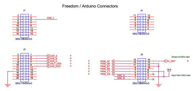

I bought one FRDM-KV31F and I am trying to connect on my own BLDC  HV power stage. It should be sensorless with BEMF references. Now I realize the FRDM don´t receive the BEMF from motor. How can it works sensorless without measuring the BEMF?
Do you think I can make one prototype for HV using FRDM-KV31F generation code through KMS (KV31/Freedom/Sensorless Velocity/PMSM/...)? or can I generate other code like Tower and can run on FRDM?
Luciano
15,203 Views
philip_drake
If you purchased the FRDM-MC-LVPMSM power stage board then the CUR stands for current. The motor control method in use is Field Oriented Control, which does not use BEMF feedback but uses phase current for controlling the motor. You can turn a BLDC motor(which is a category of PMSM motors) with the LVPMSM power stage and KMS.

The problem is that I need make a high voltage bldc and I don't know if it works with freedom board because it doesn't use BEMF.

Depends what you mean by high in high voltage.
The FRDM-MC-LVPMSM can cover up to 48V, above that you need a HVP and a processor daughter card. The HVP is designed for 70 to appx 400 V motor control.
