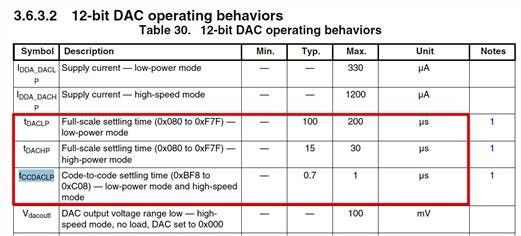

Could you please explain what is the difference between full scale and code-to-code settling time?

Settling time is the interval, within a specified percentage error band, between the time data is presented to the DAC input to update (change) and the time its analog output value reaches its final value. As you can see full scale of the 12 bits is covered in the 0x080 to 0xF7F transition.
