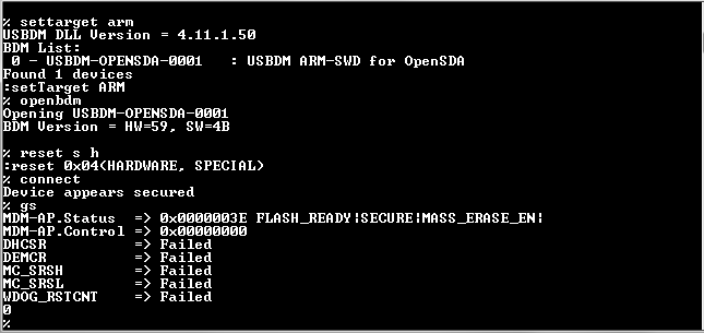

You can use the USBDM TCL interpreter to check the communication with the target and check the security state.
The following is the MDM-AP.Status result for a mass-erased chip.  This is what I would expect from a "factory-fresh" device.
The command prompt is the %
This is what I would expect from a secured device:
The above were done with a FRDM-KL43 since I do not have a separate chip to test with.
If the device is permanently secured the MASS_ERASE_EN option would be missing from the MDM-AP.Status result.

Hello pgo,
The second gif is exactly what I get:

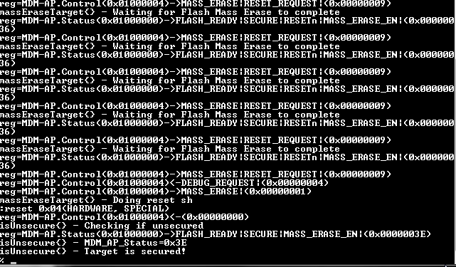

Looking into the thread you have posted... nothing worked. However I have edited the Kinetis klxx flash scripts according to one of the comments and have got the following response:
With the "normal" script all runs equal, but the end....
It seems that for some reason the register is not changing....
QUESTION: Is it normal to wait for soo long for the mass erase??

Hi Thiago,
Could you run the attached slightly modified script and see it it does any better.
It sets the internal reset request and also reports the MD_AP-Status which might be useful.
The only time I have had anyway similar results was when the power to the chip was incorrect - The main Vdd was not connected properly and chip was actually getting power through the Analogue Vdd supply - It worked OK until the higher current was needed for erasing the Flash.  This is very much clutching at straws!
You have indicated that you have good supply by-pass and such but it still might be useful to put a oscilloscope on the Vdd and Ground pins while the erase is under way to see if anything exciting is happening :smileyhappy:.
