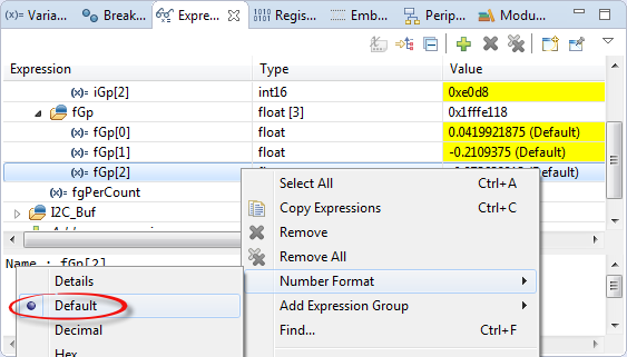

I am not familiar with that application to know what values to expect, but I tried the project in a FRDM-KL46Z and it seems to be working. Both sets of values (iGp/ints and fGp/floats) change with each reading when I run the project. For the float values please notice you have to change the format in KDS expressions view to "Default" for each fGp field (Right click -> Number Format -> Default). Otherwise, before doing this I was just seeing 0's for the 3 values. See this picture:
As recommendation do not step through the I2C code, use step over or run with breakpoints instead.
If it is still failing then it is always useful to check the SDA/SCL lines with an oscilloscope or logic analyzer to see what is going on.
