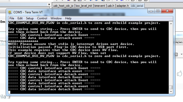

So I was able to get the HOST from:
C:\Freescale_BM_USB_Stack_v5.0\Src\example\host\cdc\cdc_serial\bm\iar\host_cdc_serial_twrk64f120m
to attach the device from SDK:
C:\Freescale\Freescale USB Stack v4.0.3\Source\Device\app\cdc\iar_ew\kinetis_k20
Now as you know I'm a novice when it comes to USB. So my goal is to send just a few bytes from host to device and visa versa  .
I see a function named
_io_cdc_serial_write_async ,Is this the function to call for that purpose? I placed a break point on this function but it never hits.
one last thing when I type characters in my terminal before I press enter, They're echoed back on screen My local echo on my terminal is off.

Hello Koorosh,
About characters being echoed, in cdc_serial.h there is a macro to enable/disable echo in serial terminal:
#define CDC_SERIAL_ECHO_BACK     (1)
So you need to set it to 0 in order to disable echoing back.
For CDC example, progam is reading data from UART (serial terminal) and they are stored in a buffer that will be sent to USB later. This data is sent by using:
num_done = _io_cdc_serial_write(s_f_usb_info.f_usb, &usb_tx_buf[usb_tx_done], (send_cnt > CDC_MAX_PKT_SIZE? CDC_MAX_PKT_SIZE : send_cnt));
In this case, s_f_usb_info.f_usb is the FILE PTR to write to USB module, usb_tx_buf[] is the buffer where the data is stored and third parameter specifies how many data will be sent.
I hope this can help!

kooroshhajiani
Thanks Issac.
Yes you’re right, I forgot to do that.
