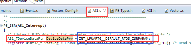

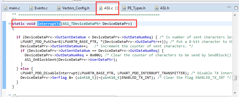

Hello Alexander,
- The function of " InterruptTx(DeviceDataPrv)" is in the file "AS1.c":

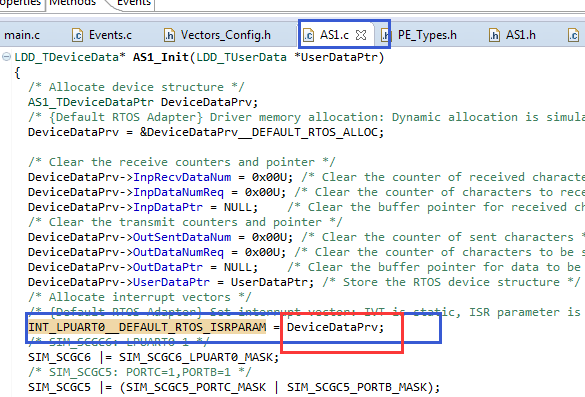

- You can find the "DeviceDataPrv" refer to the below path:
INT_LPUART0__DEFAULT_RTOS_ISRPARAM is a global variable , it is initialize in the function of "AS1_Init()" :
