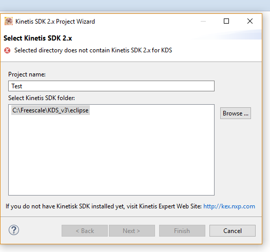

snehalnigudkar
I have installed Kinetics Design Studio Ver 3.0 & corresponding SDK (ksdk 1.2 update).Now when trying to create new
project following error appears

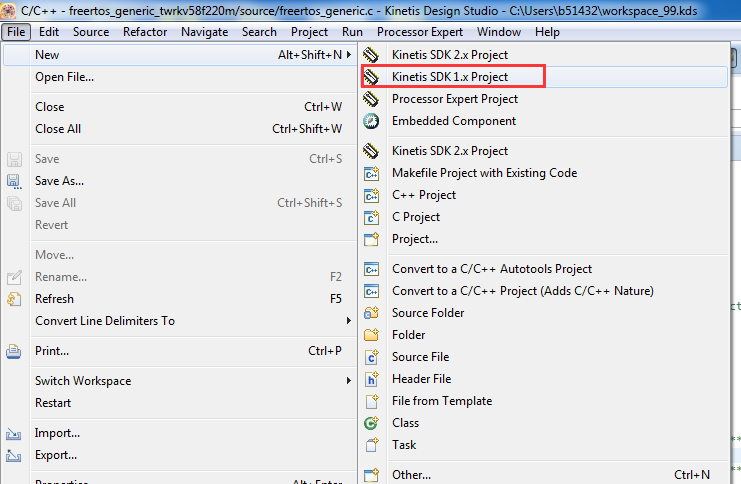

Hello Snehal,
- If you want use KSDKv1.2, please choose "Kinetis SDK1.X Project" when create project :
- If you want to use KSDKv2.x, please download the SDKv2.x package as Erich Styger said.
Hope it helps

BlackNight
You have to build  and download the SDK for your device from Welcome to MCUXpresso | MCUXpresso Config Tools , it seems you don't have done that?
