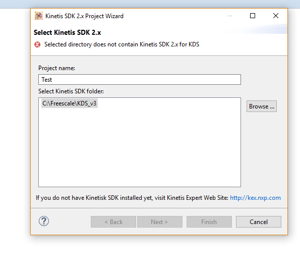

snehalnigudkar
I have used SDK builder from mcuexpresso.nxp.com. I have downloaded the received zip file from that
SDK Builder but when I am trying to add it from
Help -> Install New Software-> Add ->Archieve
It is giving me following error
1,196 Views
Robin_Shen

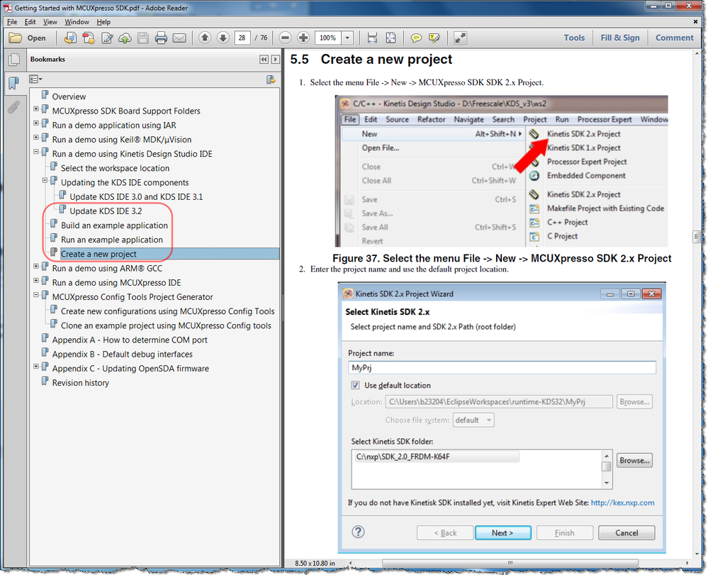

If you want to create new project based on SDK2.x, you should select the Kinetis SDK folder.
Please read the 'Getting Started with MCUXpresso SDK.pdf'.
Robin
