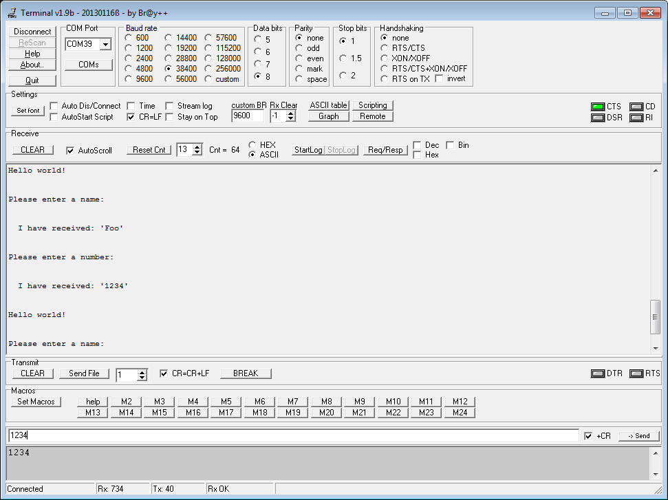

BlackNight
Hi Mike,
I suspect you run into a stack overflow or heap problem. Printf() and its friends are very problematic in my view, see the links below.
Anyway, as you still desire to use it, I have attached an example project for the KL25Z using Kinetis Design Studio.
It asks for a name and a number, and prints it to the OpenSDA USB CDC connection:
Links to the printf() topic:
