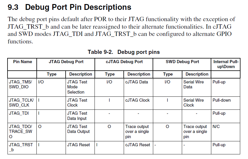

6) I plan on using this as the programmer: P&E Microcomputer Systems - USB Multilink Universal FX - USB Multilink Universal FX All-In-One Devel... , what pins are required to hook up to connect the device?

6. JTAG requires more pins. SWD is signal-wire debug so needs only 2 connections (plus GND, RESET).

6. The P&E Multilink programmer can be hooked up in JTAG or SWD modes - it is easiest to copy the diagrams for the standard reference boards.

6. is there a difference between OPENSDA and JTAG?  which pins are which on my processor?
