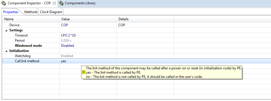

Hi All- I am using the freedom KL46Z board. When I run any code after copying (downloading) the hex file to the FRDM-KL46Z E: drive (as it appears on my PC),  the code appears to only work for a short duration: e.g. I had two successive lines to print a char to a terminal - It only prints the first, each time I reset, it just prints the first char. I thought it was my uart routine, so I used the code below just to light an led -
Bit1_SetVal(); switches the led off and Bit1_ClrVal(); switches it on.
If I do:
Bit1_SetVal();
Bit1_ClrVal();
then the led lights, but if I do say...
Bit1_SetVal();
Bit1_SetVal();
Bit1_ClrVal();
then it doesn't light. It is as though the extra delay caused by the extra line of code has stopped the main code.
It seems to be a watchdog type issue, but I have included the default line: PE_low_level_init();

jeremyzhou
Hi Russel,
Please check whether you had disabled the watchdog timer or not in the Component Inspector like the Fig 1 shows.
                                                  Fig 1

russellsher
Hi Mark - mmm right you are: I see this:
But my init code should have disabled it in PE_low_level_init();  ?

mjbcswitzerland
Specialist V
Russell
Has the watchdog been enabled with a timeout of a few seconds which could explain it resetting?
