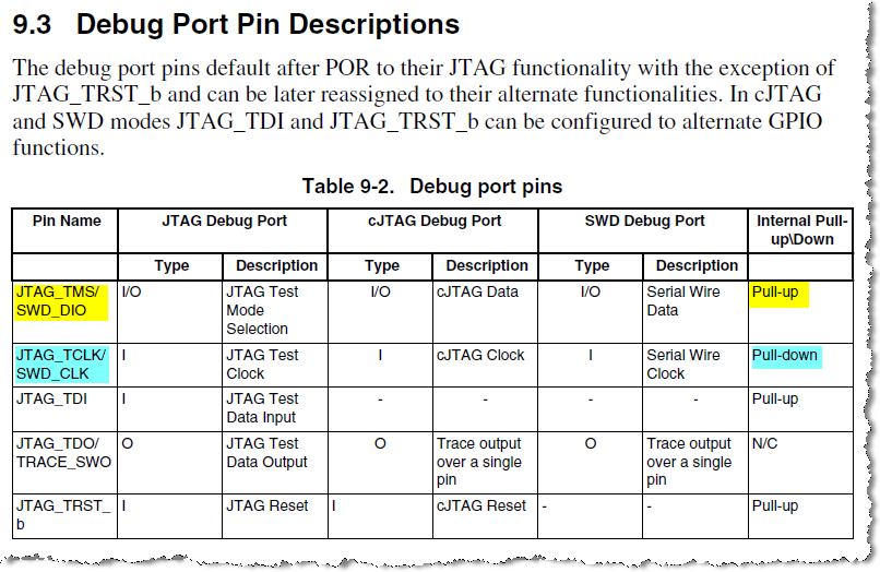

I use MK60DN512VLL10 .
Do I have to use pull-up or pull-down resistors for SWCLK and SWDIO lines?
1,767 Views
Robin_Shen
No.
These pins have weak internal pull resistors, but external 4.7 kΩ to 10 kΩ pull resistors is recommended.
Robin
1,767 Views
ilginsarican
But is this information valid for K60 Sub-Family?
1,767 Views
Robin_Shen
Yes
You can find this table in it's Reference Manual K60P100M100SF2V2RM.
