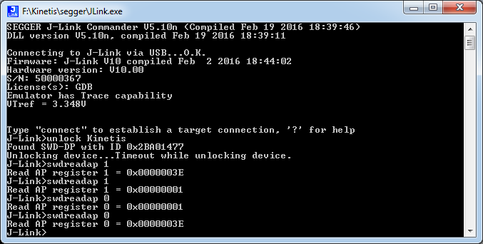

Hello.
I have a problem with MKV31F51 controller. During debug session it's stucked in secured state. A lot of reprogrammings have been done successfully but after last one "Secured Kinetis device detected" message appeared during device programming. I agrreed with prompt to mass erase device but it not help. I've tried to access device by Segger J-link debugger. AP status register (1) value was read as "0x3E" (mass erase enabled, no reset, secure is enabled), AP command register value was 0x0.
I forced mass erase by writing 0x1 value ("Flash mass erase in progress" bit) to AP command register and value from it was read as 0x1, but i received no ack about erase end, AP reg 1 value is stucked in 0x1. After half an hour a checked again and value was the same.
How can I unlock device?

Have you tried to use Segger J-Link commander tool "unlock Kinetis"  command to unlock the KV31 chip?
And below is a similar thread about how to use J-Link unlock Kinetis product:
https://community.nxp.com/message/810487?commentID=810487#comment-810487
Wish it helps.

Hi!
Yes, I've tried it but with no result:
It's a second time when this problem occured. First time it happens when I cancel chip programming in the middle of the process. We just resolder another chip. This is that chip - worked for some time but after reassemble work stand it fell to "security state" too.
