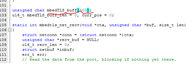

    My customer want to use K81 in simple POS project, they need to place SSL in k81, we provided lwip_httpssrv_mbedTLS solution to them. Now there is a issue in authentication, it will be failure if set to server and enable bidirectional authentication, but it is success if set to server and enable unilateralism authentication, it is failure too if set to client and enable bidirectional authentication or unilateralism authentication. Could you help to check? Thanks.

   We need to modify mbedTLS_buff size from 500 to 2000 in lwip_httpssrv_mbedTLS_freertos.c file. Thanks.
