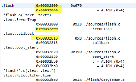

i am working with kinetis KL26Z.
i want to define some section in flash memory like bootloader, for that i am just changing linker file.
it all works fine,it create partition and show this partition in MAP file and LIST file also but when i use debug session and watch memory window there are no partiotion in actual flash memory.
why this happen?
my program also stuck and goes into default ISR.
here i attached some screren shot of my problem,
reply with your ideas.

kerryzhou
Hi Arth Shah,
   Yes, you define the m_flash region, but how you put your own data in that region?
   Your map file actually already give the detail address:
.flash and .txt.ErrorTrap  end address still 0x32800,  Your real .boot_start is from 0x32820, but the end address still seems have problem.
I think your ld file still have problem, please give me more details about how your put your data in the m_flash region.
Kerry

arthshah
hello kerryzhou
thanks for the reply.
i have flash.h and flash.c files.
i just simply devide flash.o file into my flash section in linker file.
I didn't change in my program or main file.
whatever changes made is only in linker file.
writing m_flash and create section of it in linker file automatically it puts flash.o file into that particular section.
10,642 Views
