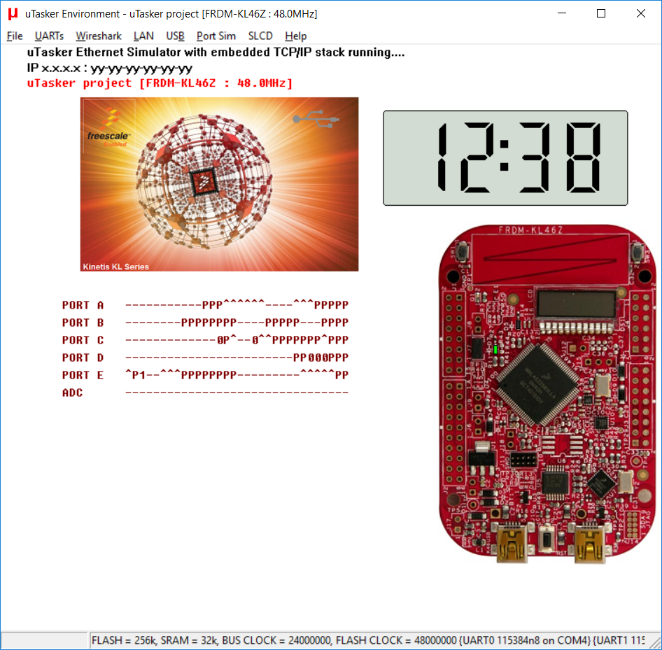

As reference - this is initialisation code for the SLCD on the FRDM-KL46
// Use MCGIRCLK (fast IRC) as SLCD source
#define CONFIGURE_SLCD()      MCG_C1 &= ~(MCG_C1_IREFS); MCG_C1 |= (MCG_C1_IRCLKEN | MCG_C1_IREFSTEN); \
                              POWER_UP(5, SIM_SCGC5_SLCD); \

And the following is a clock display updated every second by a 1s interrupt (eg. from RTC)
static void _rtc_second_interrupt(void)                                  // seconds interrupt call-back handler
    RTC_SETUP rtc_setup;
    rtc_setup.command = RTC_GET_TIME;
    fnConfigureRTC(&rtc_setup);                                          // get the present time
    if (IS_POWERED_UP(5, SIM_SCGC5_SLCD)) {                              // display time as long as the SLCD has been enabled
        fnTimeDisplay(rtc_setup.ucHours, rtc_setup.ucMinutes, rtc_setup.ucSeconds);
with the complete SLCD code below to allow digits to be simply displayed.

And finally, what it looks like when run in the uTasker simulator:
