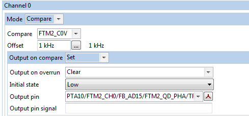

Hi Hanson,
I have checked customer KDS project. Looks like they are not configuring FTM in PWM mode, instead they configure it in output compare mode and set output on match. Please double check what they wanted.
Also you can let customer try running the same configuration by change the output pin to other FTM output pin and if they see the same behavior.
Hao
