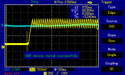

this is the first time I use this Freescale chip, I feel the reset is very tricky.
I download this code to the chip, I guess it is successful.
with FRDM-02z, the reset is high. but after I power cycle and removed FRDM-02z the reset become strange, don't understand why, if my board have problem or some setup is wrong. the yellow trace is the reset signal
need help from who has gone through this problem
appreciate your help.

this is debug log
Fri May 09, 2014 08:46:13: Windows NT detected.
Fri May 09, 2014 08:46:14: OpenSDA detected - Flash Version 1.05
Fri May 09, 2014 08:46:14: Device is KINETIS.
Fri May 09, 2014 08:46:14: Mode is In-Circuit Debug.
Fri May 09, 2014 08:46:14: CPU reset by debugger.
Fri May 09, 2014 08:46:14: Software reset was performed
Fri May 09, 2014 08:46:14: 936 bytes downloaded (11.72 Kbytes/sec)
Fri May 09, 2014 08:46:14: Loaded debugee: C:\Users\dsun\Downloads\KL04_TEST_24\Debug\Exe\KL04_TEST_24.out
Fri May 09, 2014 08:46:15: CPU reset by debugger.
Fri May 09, 2014 08:46:15: Software reset was performed
Fri May 09, 2014 08:46:15: Target reset MAP001.BMP.bmp

Hi David
This looks quite random and so probably has no real meaning (possibly the project that you have doesn't set this up correctly and so it is just random code?).
If it had a meaning it would be as explained in section 27.3.1 of the KL04 reference manual. Specifically the backdoor comparison keys would be
01 10 06 E6 4E 06 E7 4E
Various Flash sectors would be protected due to
10 00 00 0B
The Flash security would be defined by
16 (backdoor key access disabled; mass erase enabled; Freescale factory access denied; MCU security status is unsecured)
The options would be defined by
00 (low power boot, NMI disabled, RESET pin disabled)
and
03 08 have no meaning.
If the values are random it is worth working out why and setting safe values because, in the worst case, certain values could secure your chip and block futher erase operation and so render it unusable for further work.
What I have done is attach a reference binary file. This is for the FRDM-KL05 board but is probably suitable for your KL04 too (with 32.768kHz oscillator) and the processor runs at 47.97235MHz (it has a UART menu on UART0, drives PWM outputs and timer interrupts and also reads the on-board accelerometer at 400Hz, with the measurements optionally displayed on the UART - depending on menu settings). The processor is using DMA for memory movement and also for the UART transmission. The important thing for you is the binary content showing the flash configuration setup (0x400..0x40f) for comparison:
00 00 00 00 00 00 00 00 ff ff ff ff be 08 ff ff (note that the 08 configures the RESET function on the RESET pin).
Note that the uTasker project at µTasker Kinetis support and its code at KINETIS Project Code contains KL support (runs on all devices from KL02 to K70), including simulation of the device so you may prefer to start with a fully operational project in case your goals are to develop applications rather than to learn and debug each part of the device.

Check how the RESTET pin is configured by RESET_PIN_CFG in FTFA_FOPT.
This is controlled by a bit setting in configuration FLASH (0x400..0x0f). Look at the binary file that is generated to see what is set there and then work out where this can be configured in the SW in case it is not as desired.

I checked .out file, at address 400 to 40f are
01 10 06 E6 4E 06 E7 4E 10 00 00 0B 16 00 03 08
could you please tell how to explain these values. which document explain this values.

mjbcswitzerland
Specialist V
Hi David
10 00 00 0B
and

If I understand correctly you are using a FRDM-KL02 board as debugger to a KL04 (that is you have connected the SWD lines from the K20 on the FRDM-KL02 to the SWD lines of the KL04 on the other boards). It sounds as though the debugger is basically working.
The FRDM-KL02 board appears as an external hard-drive to the PC that it is connected to and a binary image can be loaded by simply dragging and dropping it to this hard drive. Thsi will program the binary image to the processor that it is connected to.
You can also use IAR to "connect" to the board rather than downloading to the board and use its register view to read register content.

Freescale support help me generated a program and now I can load the code and see the pin toggle waveform.  but he or she don't know how to set the chip in deep sleep. here is my code, it not work. could you please give me some hint.
