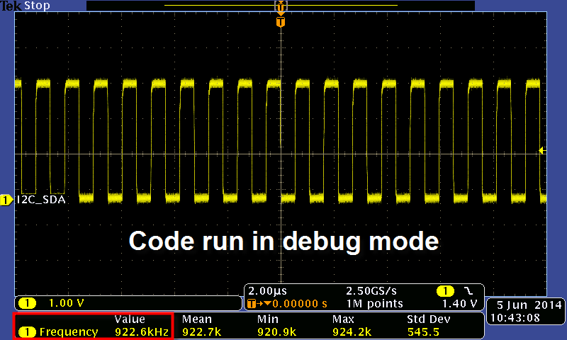

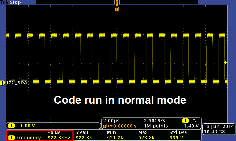

I do a test with TWR-K20D72M board to toggle PTC9 pin using Processor Expert [BitIO_LDD] component with CodeWarrior v10.6.
From attached scope screen copy, there without any difference when the code run with/without debugging.
I set the K20 core clock/bus clock run at 50MHz and Flash clock run at 25MHz.
The test code also be attached.
Wish it help.

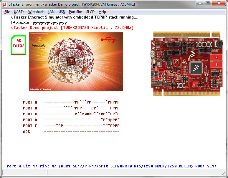

Below is a screen shot of the simulator running the TWR K20N72M board - with UARTs (connected to PC COM ports for real-time operation) as well as USB, SD card (via SPI) etc.
Complete code can be downloaded from KINETIS Project Code Attached is also a simulation executable that can be started by double clicking uTaskerV1-4_K20_TWR.exe (no installation needed) - it connects to COM 9 and attaching a serial loop back device allows controlling its command line menu, which enables working with the SD card, checking the accelerometer operation, controlling LEDs on the board and various such things.
