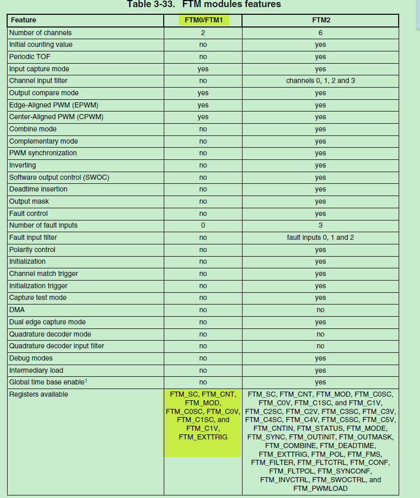

I'm trying to demodulate an Ir input using FTM inputs. I managed to use ACMP I/Os to filter IR receiver hysteresis, nevertheless, when trying to configure FTM1 to filter carrier frequency I get stucked on configuring some FTM registers. When I try:
FTM1->SC = 0;
FTM1->CONF = 0xC0;
FTM1->FMS = 0;
FTM1->MODE = FTM_MODE_WPDIS_MASK;
FTM1->CONTROLS[0].CnSC = FTM_CnSC_ELSA_MASK;
FTM1->CONTROLS[0].CnV = 0x3FFF;
FTM1->FLTCTRL = FTM_FLTCTRL_FAULT0EN_MASK;
FTM1->FLTPOL = FTM_FLTPOL_FLT0POL_MASK;
accessing FMS, MODE, FLTCTRL of FLTPOL from FTM1 i get pushed to a WatchdogIRQ (probably an unhandled Default_IRQ).
Using same registers from FTM2 give me no such error! Although FTM0 and FTM1 doesn't allow access to those register. Am I missing any config?

Hello Otavio Borges,
     Please take care, FTM0,1 is not the same as FTM2, FTM0,1 is the basic FTM component, more details, you can find it from the KE02 reference manual.pdf
the table 3-33. FTM modules features
So, you can't configure MODE register in FTM1, it is correct, because FTM0,1 don't have this function.
Wish it helps you!
