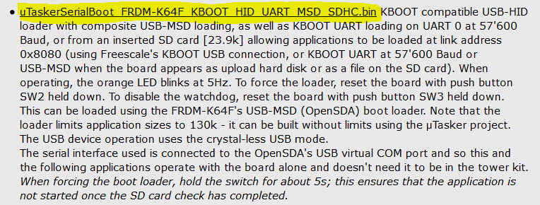

>>how to download bootloader file. there no option to download file.
Do you mean how to download it from the web site? If this is what you mean you just click on the file link high-lighted in yellow:
There is also a verson for loading via Ethernet (from any web browser) called uTaskerSerialBoot_FRDM-K64F_KBOOT_HID_UART_MSD_WebServer.bin (rather than with SD card loading).

mjbcswitzerland
Specialist V
If you install a boot loader from µTasker Kinetis FRDM-K64F support (also allows USB-MSD loading) then the new code will start without needing to press the reset button.

hi,

mjbcswitzerland
Specialist V
