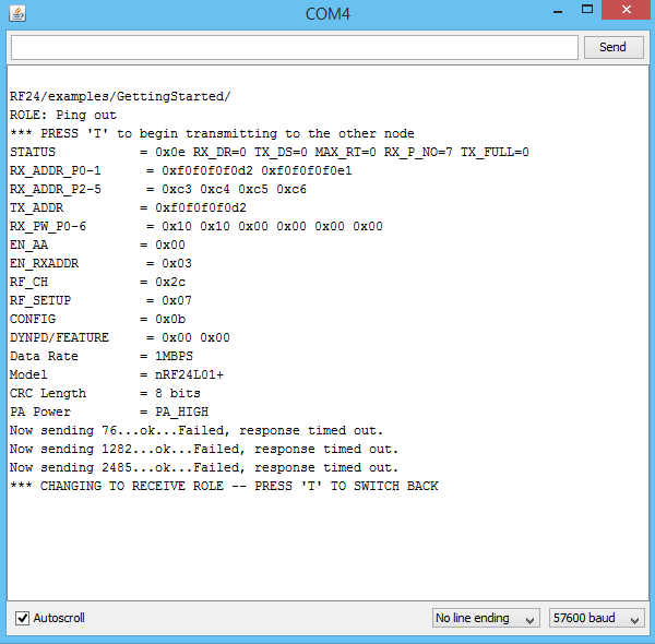

It is falling into this if
  if (status&RF24_STATUS_MAX_RT) { /* retry timeout interrupt */
What should I do? I've tried to switch addresses, channels and everything else
Comparing to arduino output:
I dont really know what I'm doing wrong.

Check how RF24_CRCO is defined.
If it is not 0 it is in fact enabling 2 CRC bytres and so would mismatch with what the arduino setting states.
If this is the case the comment in the tutorial is incorrect (I always suspected the comment but don't use the tutorial code so never looked in detail).
Also try sending to endpipe 0 rather than endpipe 1 - it may be that only endpipe 0 responds with ACK (the RF chip is quite useful but doesn't always behave as expected and as detailed in the data sheet).

Okay so by the nRF24L01.h header file I've get the definition of RF24_CRCO:
#define RF24_CRCO        (1<<2)  /* CRC encoding scheme, 0: 1 byte, 1: 2 bytes */
And is used here:
RF_WriteRegister(RF24_CONFIG, RF24_EN_CRC|RF24_CRCO|RF24_PWR_UP|RF24_PRIM_TX); /* enable ? byte CRC, power up and set as PTX */ /* Power up in transmitting mode */

I don't see where the arduino code is actually setting the CRC but from the output it is CONFIG = 0x0b. This is EN_CRC only, corresponding to teh arduino enum of RF24_CRC_8.
As see from the define RF_CRCO being 0x04 it means that the tutorial's comment "? byte CRC"means that the actual number fo bytes was probably unknown, but is clearly 2.
This means that this is not compatible with arduino's single byte setting.
You therefore need to remove the RF_CRC0 bit.

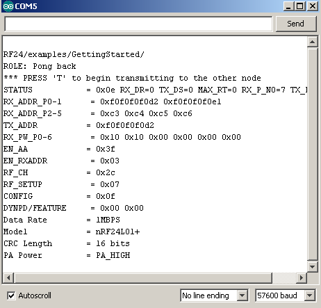

Okay so now I've got CONFIG 0x0f in the arduino side.
By doing this
radio.openReadingPipe(1,0xF0F0F0F0E1LL);
I've set P1 to 0xF0F0F0F0E1LL right? Since the only address on the KL25Z is
static const uint8_t TADDR[5] = {0x0F, 0x0F, 0x0F, 0x0F, 0xE1};
I can therefore assume everything's okay in the pipe mapping matter.
Configuring CRC to 16 bits AA's set to 0x3F.
So what's not working now?
I debugged the isrFlag, that only triggers at
Any ideas?

mjbcswitzerland
Specialist V
Try using endpipe 0. As I mentioned earlier I don't know whether all endpoints ACK correctly. Endpoint 0 certainly does though.
Also see whether the arduino receiver is actually receiving anything. If not the problem is the direction -> arduino. If it does, the problem is in the ACK direction (which doesn't mean that the receiver doesn't receive the data correctly).
