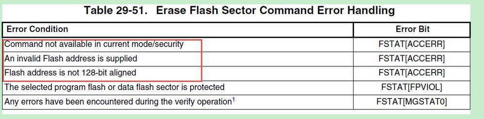

When trying the example  flash project the erase sector always return 0x20 why ???
2,403 Views
Hui_Ma
Hi Don,
The routine will returned the FTFE_FSTAT value, the 0x20 means ACCERR bit is set.
When execute Erase Flash Sector Command, below situation will report ACCERR error:
Wish it helps.

Donsnook
Ok the issue was that HSMODE was enable had to change to RUN mode
