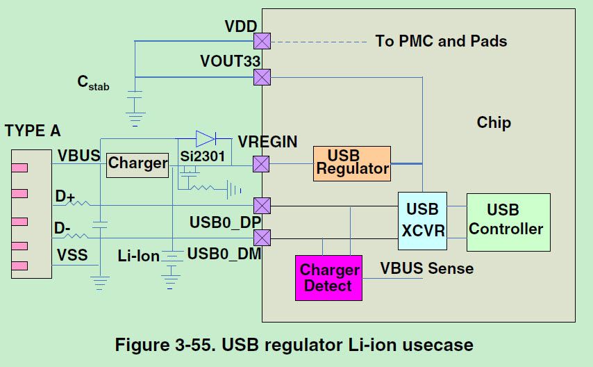

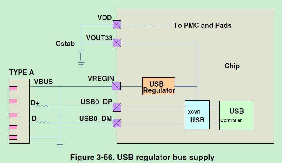

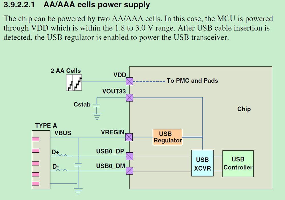

There are some designs about how to use USB regulator output voltage, below is some abstracted info from K40 reference manual:
1> AA/AAA cells power supply
2> Li-Ion battery power supply
3> USB bus power supply
Customer can refer AA/AAA cells power supply, as it is using another power to power the K40 and the board.
Customer need to connect USB VBUS line to VREGIN pin, then it will auto power the VOUT33 (also the USB transceiver ).
The USB voltage regualtor will get power from VREGIN pin and output from VOUT33 pin, by default, the USB voltage regulator is enabled.
Wish it helps.

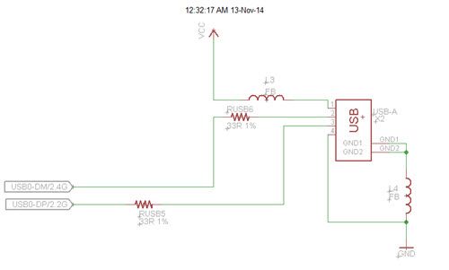

Thank you but I think I do not understand yet. We are not using any power from the USB VBUS line (pin 1 of the A connector) we have that connected to VCC of the power regulator. It seems like we have made a mistake in the design, is that correct?
1) we do not use VOUT33 to power any of the K20, the Tower reference design does. Would you recommend powering the K20 from the VOUT33 line? We have a regulated 3.3v Vdd power right now direct to the K20, VOUT33 is floating, we will add the cap if we do not use it.
2) We have VREGIN tied to VCC 5V, VCC is also tied to pin 1 of the USB A connector which is directly from the 5v  regulator. Is this wrong?
From what you are saying we should not tie USB A pin 1 to VCC, but tie directly to VREGIN, but there is no power from the USB A connector, this is only used for a flash drive.
3) Are we wrong in using Vcc for the USB line, should this be 3.3v?
4) I am sorry but I don't understand this. There is no power from the USB A pin 1 on just a flashdrive system, and VREGIN would have not power if nothing was connected to this input. How do we get 5v to the VBUS pin when VREGIN is an input??

our usb cct
Thank you for the help

Hi, Robert,
No, there is no need to power the K20 with VOUT33 line. Your design should works. The VOUT33 must connect the external 2.2uF cap.
It is correct.
K20 VERGIN should be connect with USB VBUA directly.
You can connect K20 VDD to external regulator 3.3V output.
From your design, the K20 VREGIN connects with USB VBUS, there should be correct.
Wish it helps.

Hi Robert,
For K20 USB module will be used, the VERGIN should connect with 5V power, whatever 5V coming from on board 5V power or USB VBUS.
For the USB application, the VCC should be 5V in your design.
Your design as USB host, provide power to external USB device. So you can use VCC(5V) connects with USB-A pin 1 and use VCC(5V) connects with VREGIN pin.
The USB transceiver works with 3.3V, the USB D+/D- signal is 3.3V also. Only the VBUS is 5V.
