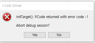

I am using the frdm-k22f board with IAR.
If connect J-link to J11 header (SWD Debug) and click Debug button in IAR, it will get error that connection is not possible as follows.
InitTarget (): PCode returned with error code -1.
All H/W connections have been verified.
I do not know what is happening.

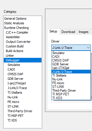

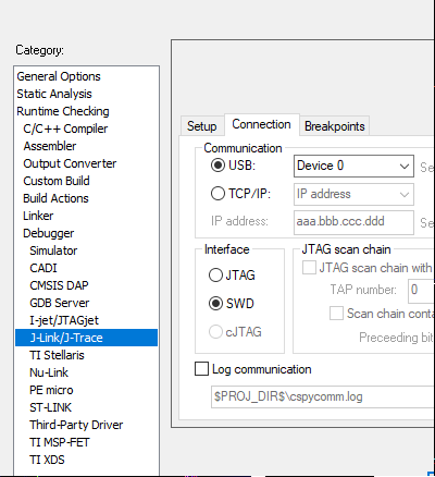

Could you please check if the project is configured as follows:

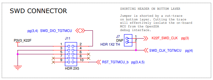

As you can see from the schematic, the J-link connection is through a SWD interface.
Also, could you please check if both J10 and J13 jumpers are disconnected?

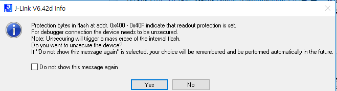

A new error has occurred\
It seems that the OpenSDA bootloader is in flash.
so if i click "yes" button, bootloader may be erased.
I'll try if I can get an extra frdm board later.
best regards.
2,930 Views
shkim9
this problem solved.
after unsecure device ("yes" click) , power off/on, debug connection successfully established.
